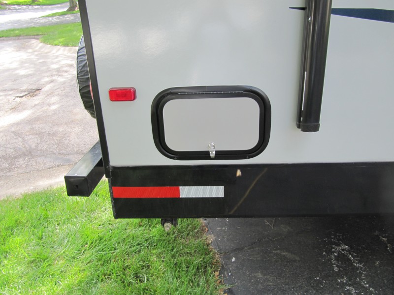

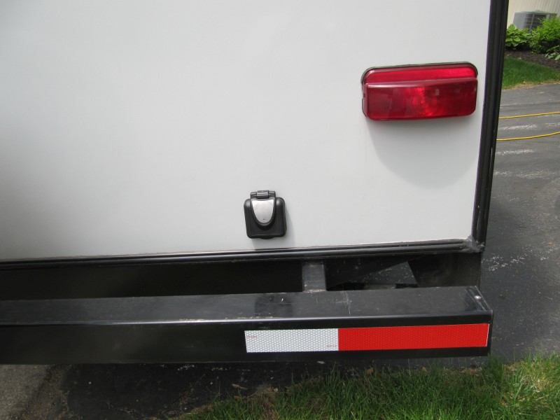

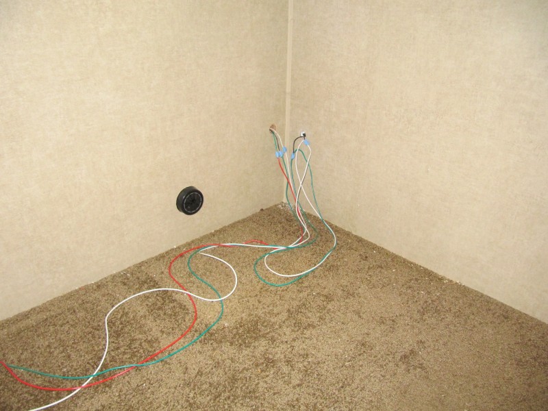

Busy afternoon. I pulled out the jack knife sofa and the plywood box that held the 30 amp cord. Then I installed a new 30 amp marine style port in the back and attached a new end to the original power cord. I plan to store the power cord inside my new door. The port connects under the kitchen counter. I didn't want to run the power cord behind my new recliners. I did leave the original power cord cover/hole. It should be handy to run a separate 20 amp extension cable inside for my electric heater.
In case anyone is wondering, the exterior walls are 1 1/4" thick. The wall has a 1" styrofoam center. There is an 1/8" laminated inside and outside surface. I'm not sure of the studs, but there is a 1" x 1" square horizontal aluminum tube at the bottom of the walls that acts as a sole plate.

I neatened up the taillight wires after this picture was taken and put them in a flexible conduit.
New 30 amp marine style port.
New storage door.
